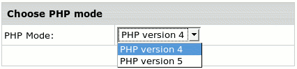

  4. ( in 3.0 for Windows-based accounts and in 3.1 for Unis-based accounts) If you wish to have the different PHP version than the default one set by the administrator. Choose the PHP version from the drop-down box if you wish to have the different version than the default one set by the administrator:

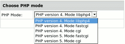

new Starting with H-Sphere 3.1, you can have more options in choosing different PHP modes for PHP 4 and PHP 5 versions. For this, first disable the PHP option on the Web Service page and then enable the Advanced PHP option below. You can choose between the following modes, if enabled by your administrator:
  • libphp - PHP runs as an Apache module. The advantage is that PHP is always in memory use which results in a higher speed capability and lower server load.
  • cgi - PHP runs as a CGI script in a separate process which starts with each request and completes its work upon the script execution. This provides a simpler and more secure PHP work, but draws excessive memory usage and higher memory load.
  • fastcgi - PHP also runs as a CGI script, but under a single process which does not stop when the script is executed. This allows to minimize server load while running PHP in CGI mode.

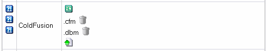

  5. If you need to add custom file extensions to be handled by ColdFusion, click the Add icon that has appeared next to the PHP option:
  6. On the page that appears, enter an extension for your PHP pages beginning with a dot.

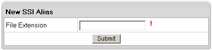

  3. On the Web Service page, scroll down to find the SSI option and click the Add icon on its right.
  4. Agree with the charges, if any.
  5. In the window that appears, enter your SSI file extension beginning with a dot:

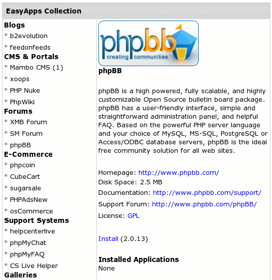

  1. Select EasyApp in the Domain Settings menu.
  2. On the page EasyApps Collection that shows, you'll see the list of applications that can be installed:
  3. Press on the title of application you want to install.
  4. You'll find yourself at a page with its description (outline, homepage, diskspace etc.) and a link to install it:

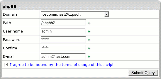

  5. Click Install. The page similar to this will appear:
  6. Fill in the necessary data:
    • Domain - choose a domain, if you have more than one, to install the application on.
    • Path - location of the application, when you have installed it, in relation to the domain's root directory.
    • User name - name of the application's administrator.
    • Password - password of the administrator.
    • E-mail - electronic address to send notifications to, which'll be written in the application config file.
    In rare cases, such as with Advanced Poll etc., you will be redirected to the original installation page.
    In case of more extensive data to fill in, refer to the application's documentation.
  7. Press Submit Query.

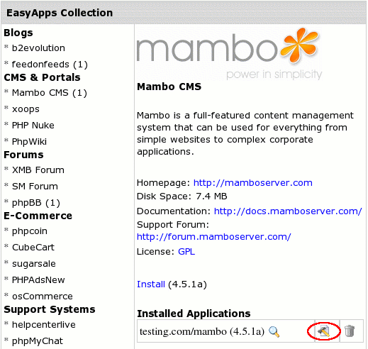

  9. After the application is installed, you'll find it on the page with its description under Installed Applications. Press the Edit button to change its settings:
