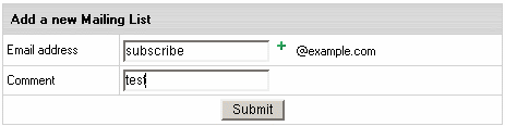

Creating Mailing Lists
To create a mailing list:
  1. Select Mail Info in the Mail Info menu.
  2. On the mail domain controls page click New Mailing List
  3. Create the mailing list using the form that appears:
    • E-mail address: the name of the mailing list from which mail will be forwarded to subscribers.
         * Note: you can enter only a new e-mail address. If you need to use an existing address, first delete the resource that uses it.
    • Comment: a comment that will help you identify this address among other mail resources, if needed.
  4. Agree to additional charges if any.

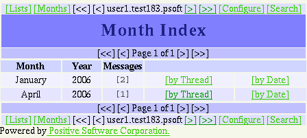

    Starting with H-Sphere 2.5 RC 3, you can view mailing list archive from your Control Panel. For this, click on the magnifying glass above the Archived option:
    This will carry you to a web interface where you can view and search for monthly archived messages received by your mailing list:

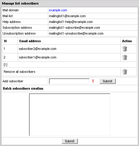

Managing Your Mail List Subscribers
The number of subscribers shows in brackets in the mailing list Properties column.
To add subscribers to a mailing list:
  1. Click the Subscribers icon in the mailing list Properties column on the mail domain controls page.
  2. Enter subscriber's email address in the Add subscriber field. To add several subscribers at once, enter their e-mail addresses separated with line break in the Batch subscribers creation field:
  3. Click Submit.
To remove subscribers from a mailing list:
  2. Click the Delete icon next to the subscriber to delete subscribers one by one or the Delete icon in Remove all subscribers.

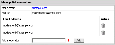

Managing Your Mailing List Moderators
Moderators approve of message posts and requests for subscription. Individual moderator's addresses are kept secret, even from other moderators. The total number of moderators is displayed in brackets in the mailing list Properties column.
To add a moderator to your mailing list:
  1. Click the Moderators icon in the mailing list Properties column on the mail domain controls page.
  2. Enter moderator's email in the Add moderator field:
  3. Click Submit.
To remove a moderator from your mailing list:
  2. Click the Delete icon next to the moderator

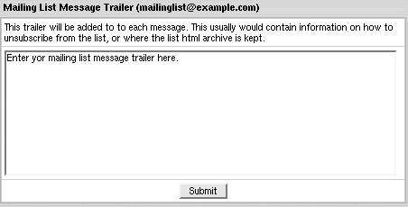

Adding Mailing List Trailer
Message trailer is a uniform text added to each message. Typically, it contains instructions on how to unsubscribe from the list and similar information for subscribers. There can be only one trailer for all messages within one mailing list.
To add a message trailer:
  1. Click the Trailer icon in the mailing list Properties column on the mail domain controls page.
  2. Enter the text that will be added to each of your subscribe messages:
  3. Click Submit.
To edit a message trailer:
  2. Edit the text and click Submit.
To remove a message trailer:
  2. Remove the text from the text field and click Submit.
