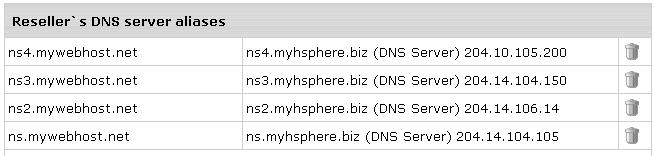

Once you have created your name servers in the Control Panel, you will have been assigned unique IP addresses for each of them
In order for your name servers and DNS zone to work, you must create these name servers with the Domain Registrar you have registered your dns zone domain with. Most domain registrars provide some provision to allow you to create your own name servers with them. Please contact them or read their Help guides to find out how. You can find flash tutorials on how to create your own name servers with several registrars here. If you registered your DNS zone domain with us as your registrar (from http://domain.jodohost.com - this is recommended), click on "Child Name servers" for your domain to create the name servers
In the case above (if mywebhost.net was your DNS host name), you'd have to create all the listed name servers for mywebhost.net at your domain registrar, pointing to each of their corresponding IPs. i.e.
ns4.mywebhost.net > 204.10.105.200
ns3.mywebhost.net > 204.14.104.150
ns2.mywebhost.net > 204.14.106.14
ns.mywebhost.net > 204.14.104.105
(your actual IPs may vary)

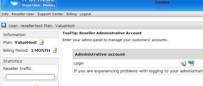

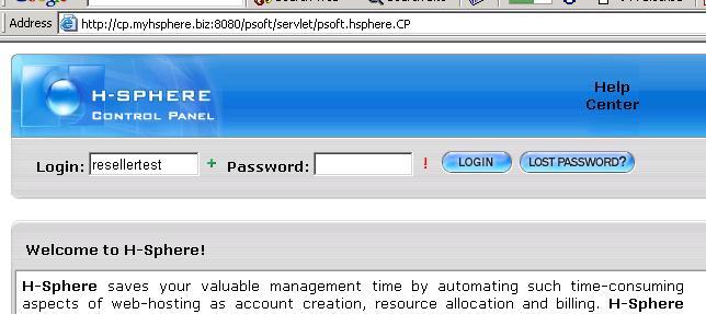

Login to your reseller account like before from the CP url sent to you in your Welcome email:
After logging on, you should see a screen like this:

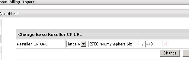

From the "Info" menu, select "Change URL"
Ensure:
1) Protocol is http:// and NOT https:// (Use HTTPS only when CP SSL is enabled - refer to Support Manual)
2) Given control panel url is cp.mywebhost.net (where mywebhost.net is replaced by your DNS host name)
3) Port is 80 and NOT 443. Use 443 with CP SSL
Once done, click "Change". You'll be taken back to the same screen.
Now you can access your control panel from http://cp.mywebhost.net (where mywebhost.net is replaced your DNS host name). You can now directly use http://cp.mywebhost.net to login into your Administrative Account. Just enter the username and password you entered while creating the Administrative Account.
